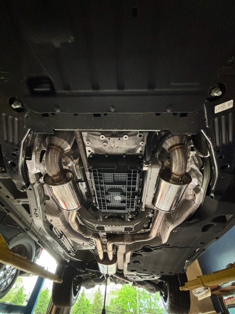

Hello,
Ask: How limiting is the stock catback exhaust with upgraded turbos (Whoosh Stage X), fuel (Nostrum Stage 3), all supporting mods, and ZFG E85 race tune? Or would that be a waste of the upgraded turbos and fuel build.
Situation: My '22 ST is my daily driver. I purchased/installed a 3" AWE system connected to SPD catted downpipes, and the drone/noise is more than I expected/want. If the SPD catted downpipes + factory exhaust will support 99% of the turbo/fuel/e85 tune's potential, I'll return to stock catback and sell the AWE system while it's a few weeks old.
What I've found in research before posting / my effort to not waste your time: closest I've found are references to performance before/below upgraded turbos and fuel (plus all supporting mods). I've found no builds or references (explorerst.org or on the internet) for this build setup with stock exhaust.
Build List:
*aFE intake (replacing with FenFab prior to final tune)
*CVF intercooler piping
*Whipple IC
*SPD catted DP's
*AWE 3"
*Whoosh X's arriving shortly
*Nostrum Stage 3 (w/Goliath pump) in production
*ZFG tunes (91 Performance Current; E85 race once turbos/fuel is in)
*Suncoast Stage 3 rebuild once the stock 10R60 breaks
*All the suspension mods/bracing except FSB
Thank you,
DB

You’d be the first one to try I guess with your mods. I wouldn’t see a humongous detriment to performance (I’m just speculating), but the stock exhaust has proved to flow well all the way to 600 awhp, and after that I’m assuming it’s relatively minor gains from there.
D
Minnesota
Thank you. If that continues to be the feedback then it may be a lab rat situation. Install the stock catback, and if after tuning Adam@ZFG thinks there’s significantly more power to be had, I’ll look for a milder 2.5” system. Otherwise, good to go

Veering slightly from the topic, people often confuse drone and volume. Did the exhaust combo boom inside the cabin (drone), or is it just louder than you thought it was going to be? I have an AWE sitting in my garage, but honestly think the stock mufflers LOOK awful, I don't necessarily want or need an incredibly loud daily driver.
Back to your topic of airflow, I think it will depend on your setup, and you're entering territory that not many others have. Do I think everything will certainly flow better? Absolutely, do I know if the gain will be 4WHP or 40WHP? No way to tell until you try.
Another consideration is going to be which cats you use. Once you're above a certain power level, GESI cats (KOOKS, Upgraded SPD, for example) flow better, vs 400cell generics that you find in Standard SPD/CVF/FenFab

Another option is adding Vibrant Ultra Quiet resonators to your AWE system, they're a game-changer and I'm surprised more people that aren't happy with their 3" volume levels don't do this before selling them or trading for a 2.5". The stock system likely isn't restrictive enough to hamper much power. Plenty of 900 whp Coyotes are running 2.5" exhaust and the 3.0L will never be near that.

It’s both. I’m experiencing drone (resonance that vibrates interior panels and my brain) at sub-2500rpm / less than 30% throttle. I haven’t measured the decibels but I’d estimate the inside of the cabin to be 100db+ at sub-30% throttle, which makes it very loud even when you’re slightly accelerating. It is incredibly loud.
30%+ throttle and upper rpm range is a great/clean sound and exactly what I was hoping for (closer to a Maserati Ghibli V6 twin, but louder).
Understood on the true high flow cats.
Great feedback, thank you Beerman. I will look into those. The AWE is very high quality with excellent fit/finish. The Vibrants could be a great option if they help solve for resonance and volume.

There are a lot of good videos on YT that show the difference they make. @UNBROKEN led the way here from what I know and I took his lead. I'm old now and didn't want my ST as loud as my Trackhawk was, so I added the Ultra Quiets to my Thermal 2.5" when I did the CVF downpipes and it sounded a tad quieter than before the DP's. They've burned in a little now and sound perfect - for me.

Another plus one for the Vibrant ultraquiet. When I added DPs to my Thermal it was a little too loud for my taste. A pair of ultraquiets put it back in the sweet spot for me.

Don’t waste your time on the Vibrant bottle style. I tried those and replaced them with the ultraquiets and wasted a couple hundred bucks

I actually ran the stock cat back with crp stage 5s, cvf downpipes and stage 3 fueling, making 509 whp on 93. It was very quiet and worked ok, for about 900 miles. Apparently, the back pressure produced by my stock exhaust destroyed the stage 5s. CRP did an after action report and said the excessive back pressure is what caused the failure (passenger shaft broke at the turbine). Both thrust bearings displayed the same wear and the drivers side had a fatigue crack in the shaft. I heard the same stories that the stock exhaust was good for 600 whp. Mine certainly wasn't.

Loaded, thank you. That’s great feedback. AAR’s are valuable. Sticking with the AWE 3” and asking the local exhaust shop to cut/weld in dual Vibrant resonators, and it will be what it will be. I’m sorry about your turbos.

Report back after you get them installed. I think you'll be happy. I'm in MN too, not sure where you are but I used Tim's Custom Exhaust in Coon Rapids, they do good exhaust work.

Ha Beerman that is the last sign I needed. Found Tim’s Custom Exhaust via search yesterday, and it’s next to Jellybean and Julia’s. Best BBQ in Minnesota. Since you’re endorsing them, that’s where I’ll go.
Will report back here with the AAR after the vibrant installs. Turbos go in July 6, but Nostrum ETA is August.
