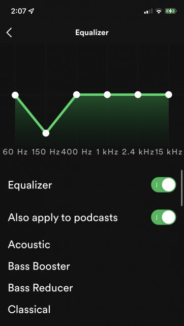

I think the sound quality of the B&O sound system stinks. Considering the premium price for both the system and the ST, it's a major ripoff. The biggest problem I hear is that the mid-bass is over-emphasized, which makes the overall sound very muddy. It's not an enjoyable listening experience and Ford should be ashamed of it.
I've found a way that makes the system sound pretty good most of the time - as long as you're using Spotify. Go to the Spotify home screen on your phone and access Settings in the upper right corner. Select Playback, Equalizer and set the EQ like the photo below. This removes the most offensive part of the low-mids that are over-emphasized in the default B&O settings. On the radio, I leave the Mid and Bass in the center of their range and boost the Treble most of the way. All of this makes the system sound pretty good.
It only works for Spotify, of course, and not the radio or MP3s (does anyone use either of those?). It's not a substitute for a real DSP and proper system alignment but it's an easy fix to make much better sound.

That's a start but the stock system needs more attenuation in the treble as well and a 6 band equalizer may not do it. Bottom line, the sound is too colored/flawed and needs driver replacement to make it right. Start with 3" treble and 6x9" mid bass units in the front doors. The OE 1" soft dome is fine.

Proper sound treatments, adding a DSP and a proper tune will probably surprise most people.
A massive suck out at 180hz is definitely NOT the way to fix it.

The massive "suck out" is more like around 250hz and that's where the resonance and general nasty boominess of the stock system is centered. I made the same point you did - it's not a substitute for a DSP and proper tuning. The Spotify equalizer is crappy - no level or Q indications - but it's better than what's available in the stock head unit. AND it's FREE so you don't need to spend another $1,500+ to correct Ford's miserable tuning.

I gave it a try and it definitely helps. Cleans up a lot of the muddiness and even removes some of the rattle the doors can have. Nice find! Definitely doesn't sound good but it is better lol! I wonder if there is a decently priced DSP that can save this hot mess?
