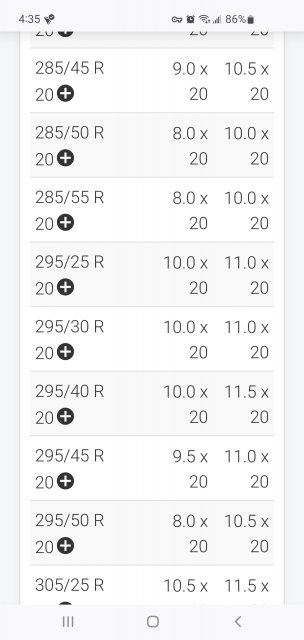

The tire size calculator site does provide information on widths. It says a 285/50R20 and 285/55R20 can go on an 8" to 10" rim, so I think 285 is okay. I would confirm with the literature of whatever brand you choose that it is okay too, but I think you are okay to use it size wise.
It looks like a 295/50R20 can also fit on an 8.5" rim. I am not endorsing it will work with an ST, but should be safe to mount.
