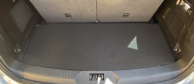

I installed a Kickey Key 500.1 and a Kicker L7T 12” Subwoofer in a custom built box downfiring above the spare tire. The box is sealed around 1cubic foot. There is a couple of inches between the subwoofer and the spare tire when mounted in place. Sound deadener was installed in the entire spare tire well. Then I ran the Kicker bass knob up to the dash panel. The stock subwoofer is still hooked up. The box has finger pull straps for easy removal and lifting. Everything is hidden away and looks factory. IMG_3368.jpeg IMG_3369.jpeg IMG_3370.jpeg IMG_3371.jpeg IMG_3376.jpeg IMG_3386.jpeg IMG_3388.jpeg IMG_3391.jpeg IMG_3409.jpeg

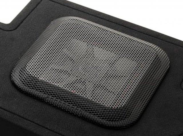

Yeah. I’m thinking about up firing the subwoofer when the new mesh grill is released for the subwoofer in early 2025. IMG_1560.jpeg

Yeah. I’m thinking about up firing the subwoofer when the new mesh grill is released for the subwoofer in early 2025. View attachment 26749
Downfire works well for these cars. You just need to vent the sides of the panel you already have.
This panel looks like nothing is there but it’s vented for a pair of 12’s and the amps underneath.
