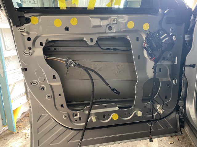

The doors have one cheap mat on the outer door skin and fiber mats on the inner door panels. It’s very minimal. The rear doors only have the fiber mat...no dampener on the outer skin. C09A11A2-9D08-400E-8FEF-8D973F02CD48.jpeg 46DC8E91-8534-4ECE-88B2-263C64BC28B4.jpeg C1B00DAC-8987-487B-B455-BF28BFA1E19B.jpeg

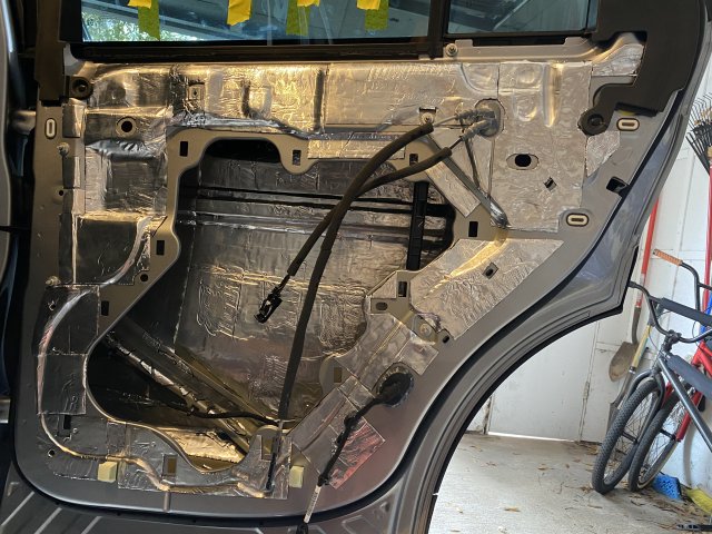

If you want it quiet...it takes some work. 873155AE-8B9F-45B5-AFCE-02740A914142.jpeg 33B4E933-5BC0-46A0-8DC6-E14A69627C82.jpeg 35B0E0DF-493B-4813-B264-393C344DBA32.jpeg

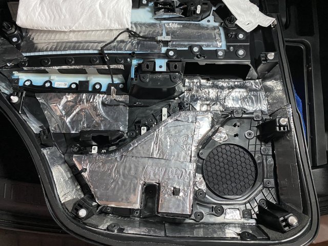

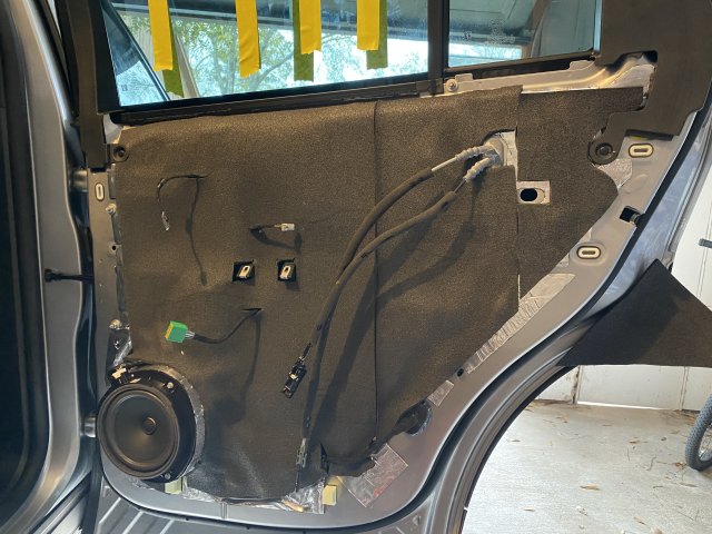

I put dynamat on all four doors and it seems to be a big quieter and more of a thump when the doors are closed. like another member had said it took a bit of work and quite a bit of time but it was well worth the effort. Next I'm going to remove the seats lift the rug and put it underneath the rug.

Stinger Roadkill Expert CLD everywhere.
Dynamat Dynaliner CCF in the doors.
Dynamat Dynapad CCF/MLV sandwich in the rear hatch and floor/spare tire well.
