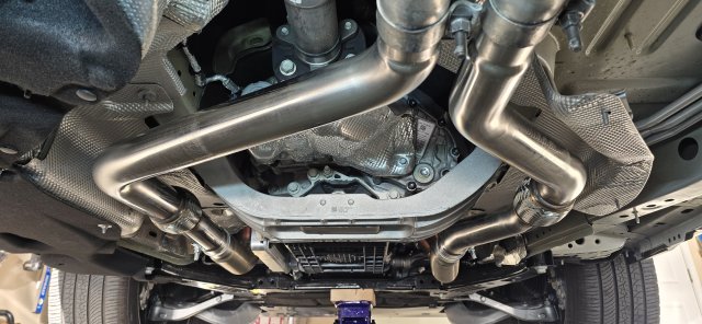

The vibration is the accordian style midpipes. I installed the SPD catted downpipes and the flex joints in the midpipes were going crazy, suddenly.
I installed 2.5 inch weave styke flex joint midpipes from Lethal and had the muffler shop add two new hangers and the vibration is GONE. This is a common issue even with the stock system.
Thank you. I just added the Lethal 2.5 mid pipes thinking mine were the issue after installing the CVF (ver. 2 - no hanger) catted dps. The rattle didn't go away, maybe it's a little better, and I now have a vibration in the cabin. I assume you added hangers at the end of the dps? Where did you put them? Again, thanks.
