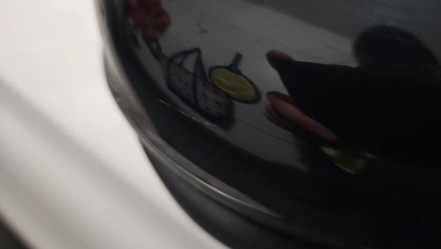

I know this is picky, and the scratch is tiny, but I just bought it and is only a couple weeks old. I can't prove it came this way from the dealer, but am wondering what options there are for touching up this minor scratch. Is there a certain type of paint I can use to fill in? Thanks!

If it's only a surface scratch or scuff, meaning you can't really catch your finger nail on it when you go over it. I'd use a light rubbing compound on it, then put a coat of wax on it and you'll be good to go.

If it's through the paint and primer is showing, I've had good luck with Dr. ColorChip. It's a product that is easy to use but they know what they want for it.
