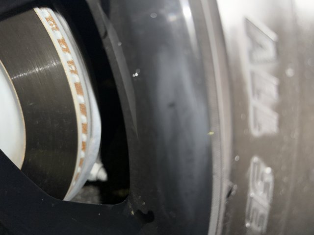

What’s up guys, anybody have any suggestions on removing these clouds off of my wheels? The wheels were ceramic coated at about 4,000 miles and I am now at 7600. I am beginning to see this haze on all four wheels in random spots.

That doesn't look like haze...those are some nasty scratches. Like someone took steel wool to spots. Were you trying to get some road grime off with something abrasive? Maybe carwash place a little too enthusiastic about scrubbing them? The clear is deff scratched.

Agree. Those are scratches. Some wax could make it look better.

Probably need to wetsand to a high grit like a 1000 or above and then get something like this small Rupes buffer with a series of lower grit to higher grit compounds and work them out.
I have one and that thing comes in major handy for small jobs in tight spaces. If it's burnt through too much however, you would probably have to resort to getting them refinished or buy a new wheel. Your call.

Aw man well that sucks. I took it to dealership for oil change and tire rotation and noticed it after I washed. I’m not sure how they got so scratched up because I am very anal about my microfiber towels and that’s the only thing I used on them. I wash my 2023 mustang GT wheels with the same brand of micro and have never noticed this.

Yeah I’ll probably just end up going with the refinish then. I got a powder coat wheel guy that can probably get that done. Appreciate the advice but I’ve seen some buffing nightmares and I am not trying to make the issue any worse lol.

***update used C4 clear cut and a buffer and it came right out. Thanks for the advice
