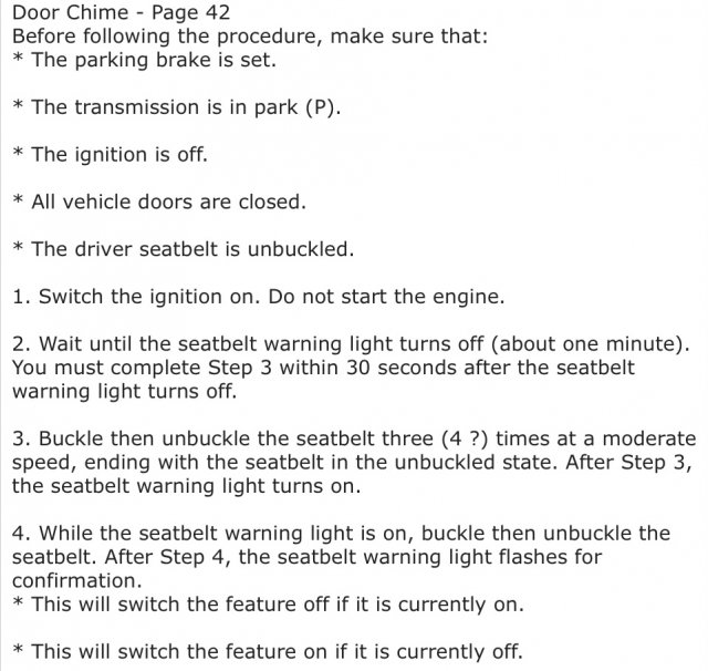

That’s exactly what I tried but after three buckles/unbuckles the light didn’t come on. I’m going to try it again though.

3 buckles and unbuckle should work …some people have reported that they buckled and unbuckled 4 times and it worked

Not sure why it didn’t work the other day or on my first try just now but the second attempt seems to have worked. The light came on and then flashed after the fourth buckle/unbuckle. Thanks for everyone’s help!

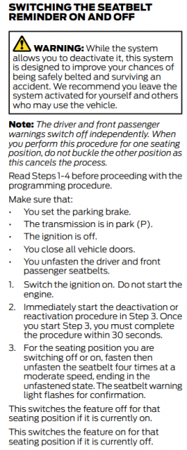

Updated: in the infotainment system there is a breakdown on how to disable this. You follow the same steps as stated above but you do it right away after turning the accessory power on. You do not need to wait for the seatbelt light to turn off. Hope this helps others!

The manual tells you how to shut off the seatbelt reminder. It’s easy to do, however it took me many tries to get the command of disabling the seatbelt reminder to stick. The 25’ software is glitchy when it comes to disabling things and Ford already has a fix it list to work on for 25’ software. I don’t understand why they can’t get even the small things right the first time @ Ford..

You do not drive while doing it.
In park with the parking brake on, turn the ignition on but do not start it. Sitting in either front seat you want to deactivate, fasten and then unfasten the seatbelt (4) full times within 30 seconds at a mederate pace.
I must of read it wrong. I tried it a few times and never got it to work. Does it actually eliminate that overhead nag shot?

It took me many times for it to finally take or keep the command of me wanting it off. At one point I inserted the seatbelt and unbuckled it a lot more than just the (4) times is tells you to do and then it finally worked.
