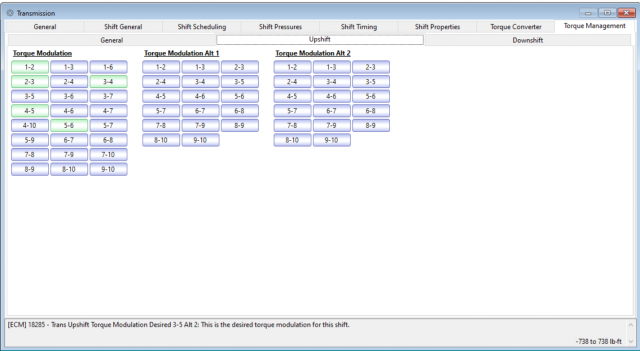

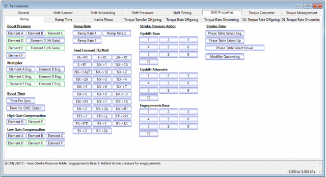

Glad you are enjoying your ST and your tune. If you are looking for an easy quick canned tune this is your best bet. The biggest limitation however is the lack of transmission tuning which IMO is where a custom tune like ZFG really shines. Enjoy your ride!
There are trans tuning changes in the canned tune.

I downloaded the latest tune from SCT yesterday. How can anyone know if they have or haven't changed the transmission settings? Shifts pretty hard now, so they've done something.
There are changes to the trans in the canned tune. I haven’t played with it much because I have several custom tunes, but maybe able to show some of the differences between stock (on a ‘21) and the canned tune.
You can give it some time to learn and the shifts should take down. If not, you can always go into the vehicle functions > special functions > KAM reset and reset the trans tables again. They should be getting reset when you load the tune, however I’ve had varying results from SCT.

Very minimal changes in the SCT canned tune. Every cell with "green" in it is a change vs. Stock
ST Stock Trans (1).png ST Stock Trans (2).png ST Stock Trans (3).png ST Stock Trans (4).png ST Stock Trans (5).png

Nice info, Blown

Am honestly surprised that there aren’t any shift schedule changes, but I guess it’s a pretty mild tune overall. It does drive pretty well though.
