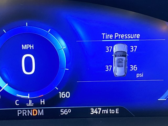

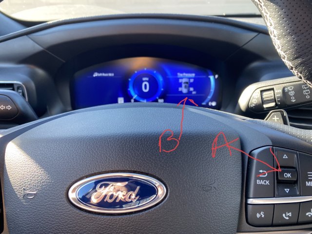

I have seen a display (using the OK toggle on the right side) which shows the 4x4 wheels and the amount of “traction/drive on each wheel. I can not find it. In the pic, A is the toggle and B is where I remember the 4x4 display appears. The one photo shows the tire pressure as an example of what the wheel traction screen would look like.

Press the menu button and display setup lets you configure which information to display there. Somehow yours got reset. There's a list of items with check boxes and you can select I believe up to 7.
