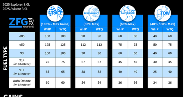

The other doubt that I have is ZFG has different applications , Race, perfomance, daily diver etc.. My logic says that I should choose the race one but to be honest dont know if this tune can works me also for daily driving and traveling in highway with the family. Whats your thought in regards these options?

Race tune is great. Drives really well even in day to day applications.

I have 134K miles on ZFG race tunes…91, 93 and E50. The car drives flawlessly. Rolled 139K this morning.
