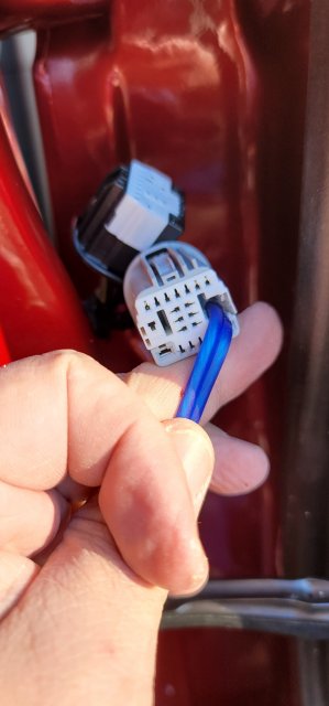

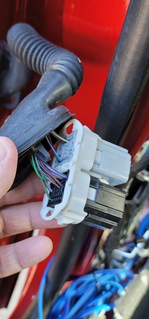

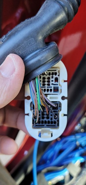

Looking at this back door, I don't see how it can be done without modification. There are plenty of open pins, I'll just drill the unused large pin on the Grey molex. I only need to open it a little bit. 20221227_112819.jpg 20221227_112749.jpg

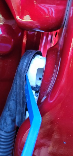

Front is different, it has a wide open spot like you said. 20221227_113801.jpg

Got the wire run in the rear doors. Drilling was too much of a hammer and tried to crack the molex connector. So I switched to using flush cutters and a hot exacto knife. 20221227_112819.jpg 20221227_152627.jpg 20221227_152705.jpg
