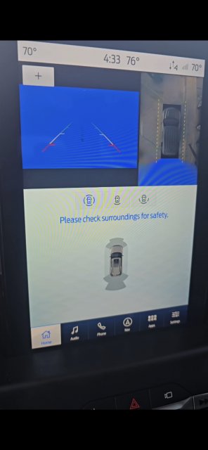

I recently had an issue when reversing where my screen goes blue on the 360 camera and just the back sensors and I get a msg that pops up saying reverse brake assist not available. It doesn't happen everytime just randomly. Has anyone else had this problem if so what is the fix

Have you had the latest camera recall done?

yup has the update been done
if its under warranty , you have an issue ...let the warranty take care of it
do you have extended warranty?
there was a customer satisfaction program as well, but i cant find it now
its an easy fix

Any Ford dealer can do that for you.
1,687
1,137
Mine was covered under the recall.

It's part of a backup camera recall. There's a good chance it was never done on your vehicle. If the dealership has the parts on hand it will be quick, I got mine done during an oil change.
