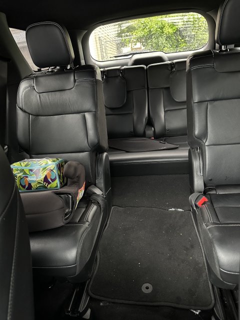

Can you pls Picture of this, i would interested how its look like when the middle seat is out of the bench.

Here’s a pic.

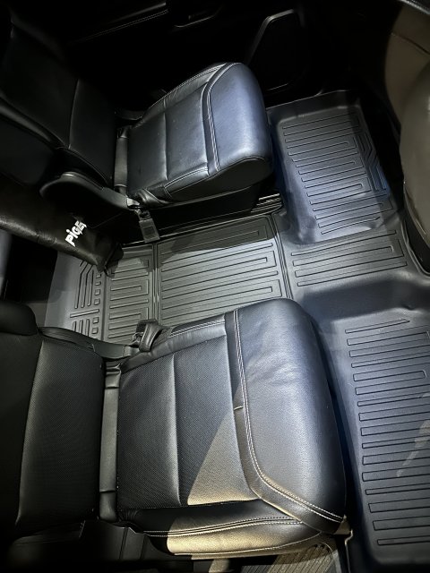

bought some knock-off floor mats for a 6-seater and it perfectly covered the gap in the middle left
By pulling the middle bench seat. This was supposed to be temporary, but the family likes it this way.
I have the middle seat bench buckle zip-tied under the driver's side seat. I'll likely go grab a buckle from the junkyard and cut/shorten the harness to make a simplified version. Without a buckle plugged in, you get seat belt warnings for the middle. Do not jumper it. The belt minder doesn't work that way I believe it is a hall-effect sensor.
But without the armrests that would be on the typical captains chairs, there is more pass-thru space. Really the main difference between this setup and true captains chairs is you lose the armrests, the seat pattern in the thigh area travels across to the missing seat, and bench seats are manual forward-access, vs the electric button on captains chairs

Using an old floormat as a temporary cover to the open spot left in the carpet. This was supposed to be temporary for a summer road trip with the family, but the kids ended up liking this a lot so it's been a few months now. If i keep it like this i'll prob go seek out a peice of carpet I can cut to shape to cover/fit the area better.

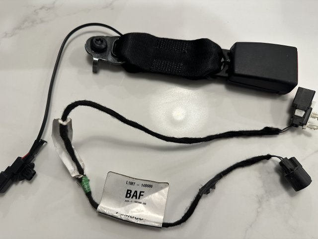

That’s what I ended up doing for the middle bench. Hated routing the harness in/out so I ended up buying a new buckle ($35 or so) and digging a harness out of a junkyard vehicle
one of these nights I’ll cut it all up to make a sort of jumper I can just plug into the middle seat plug when I pull the center seat of my bench out. Then it will be 4 bolts and unclip one plug and pull the seat out.
BTW part number for the middle buckle LB5Z-7860045-AA for about $35. Appears to be the same plug connector as all three rear seats and the cheapest buckle (for now)
