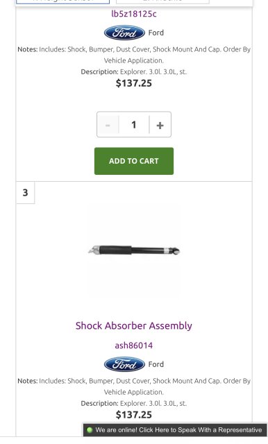

All my local dealers in my area. I'm curious if that's just in my area or if it's a “upcoming” recall Ford hasn't published yet to all Explorer ST owners.

hmmm, what’s odd with that is the PIUsa aren’t fail prone like the regular explorers. Maybe contact HSF or ZFG, they sometimes have them in stock.

Travis has them listed as out of stock but I'll check with ZFG!

Rock Auto sells oem Ford parts for the Explorer ST
Yes. they list the PIU rears on the website. I've been getting OE parts here. They usually ship pretty fast too.
