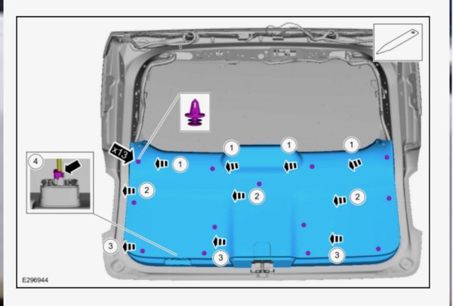

I bought the black Ford emblems from Whoosh (who is awesome). The instructions that came with it want me to pull all the trim on the inside of the lift gate, and push it out from the inside. You still need the heat gun to loosen the adhesive.

You should consider fishing the post pieces out. The interior hatch trim panels just pop right off with no tools and like 3 minutes or so of work. I know this because when I pulled my OE emblem off one of the clips fell in on he hole and inside the hatch. I was swearing at myself for letting that happen, but then only had to spend all of like 10 minutes popping the trim panels off, retrieving the clip and popping the panels back on.
