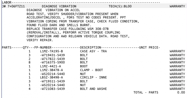

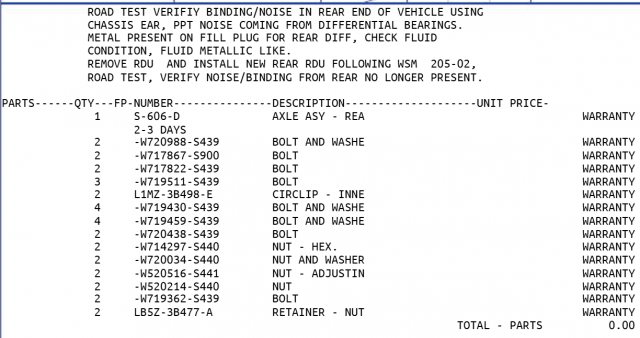

Here is an update: Picked up my ST today and it drives like it did over 4 years ago. Like a different car. It had been deteriorating for a long time and finally after the front and rear axle repairs and transfer case replacement, it drives like new! Here is the work they did: Screenshot 2024-06-06 232214.png Screenshot 2024-06-06 232237.png
