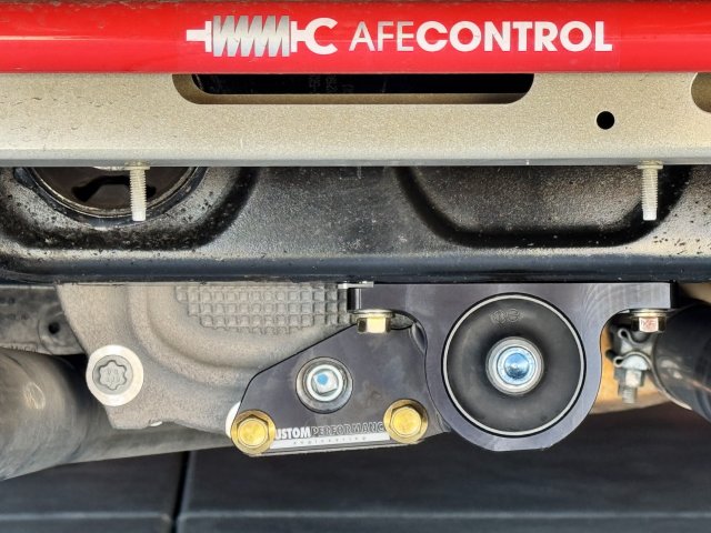

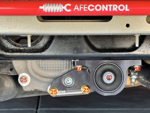

How was the install for that CPE/ID-Speed brace? I just received mine but there are no instructions.
I'm not sure if I need to lower the diff to get the bolts out or just get the e-torx wrenches (or if the e-torx sockets will fit/clear) or even what the torque rating for any of the bolts are.
The hardest part is getting to the top right E18 bolt. You will have to install the bolt into the brace first then use the indention in the subframe as a relief to get the bolt straight enough to get into the diff. I used a E18 wrench. You will need to rotate the wrench all the way up toward the body to get rotation then use a small area lower to get a small additional rotation in order to re-attach.
If you are adding a stronger diff bolt (recommended) support the diff with a jack (adjust as needed) so you can get the alignment straight to make installing the new bolt easier.
I appreciate this info and I’m liking the looks/functionality of the ID speed brace. They made the bushing out of EPDM for a reason that makes sense to me. Very useful input thank you!
