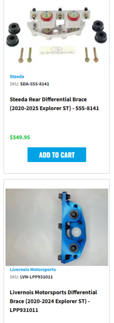

I’ve said a thousand times these double braces aren’t needed. There’s no reason to lock the rear diff down solid on a daily driver. The ID Speed brace was actually engineered to work like a 4 bolt car.
Genuinely curious....What's wrong with locking the rear diff down solid aside from added NVH?
Nothing with those type braces. Even NVH isn’t a problem with them.
It’s just not needed. People see bigger and assume better…that’s rarely the case.
