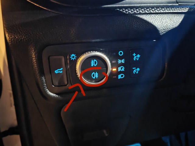

Hi,
New Explorer ST owner here. I live in the Middle East and just bought a '22 ST from a colleague. I love the car but the inspection company that I paid to look over the car missed an inoperative right rear bumper light. I believe its a fog light and I was searching for an OEM part (to gauge pricing) but I can't find the part listed on any of the American sites. Is this part an overseas (possibly euro spec) item only. I can't find anything about it in the owners manual either. I've included a picture of the operative left side light and the button that turns it on.
Thanks

The US spec ST models just have a reflector in that location. It's not an illuminated lamp on ours.

Hi,
Thanks
That is only for euro-spec cars. American cars don’t get that.

Thanks for the replies. Yeah I figured as much.
However it seems that there are aftermarket lights available that can be fit in place of the reflectors. I'm assuming that with the wiring and button already installed it'll be an easy install. I'll have a look through the lights mod forum for recommendations.
