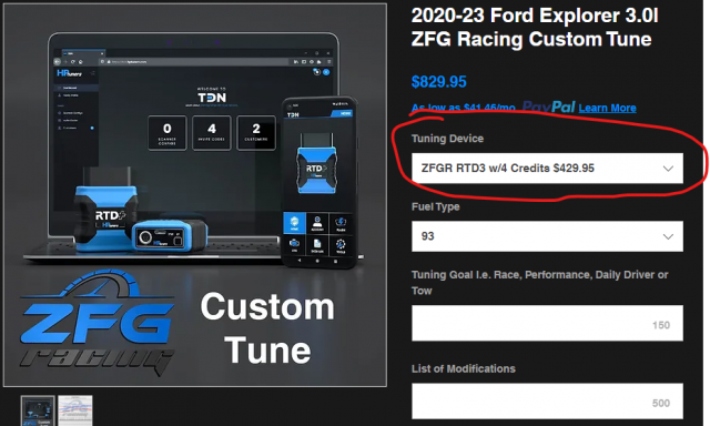

Thanks! that's what I needed to hear. How do I even start with a ZFG tune?

yup! I've been looking around the site. Still confused on what to purchase to make the tune possible.
You will pick a device to be able to load a tune on it. I picked the ZFGR RTD dongle that plugs into the OBD-II port in the car and connects via bluetooth to your phone to load the tune. It comes with 4 credits that are needed so that Adam can dial in your tune. The tune you pick is based on how you will drive it. I picked the 93 tune because this is a daily driver and will not be tracking it.
I was a bit overwhelmed at first as this was my first time tuning a vehicle, but the instructions that come with the tune walk you through it.
Go with the Stage 1. You pick your tune, pick your intercooler and check out. Best bang for the buck IMO.
