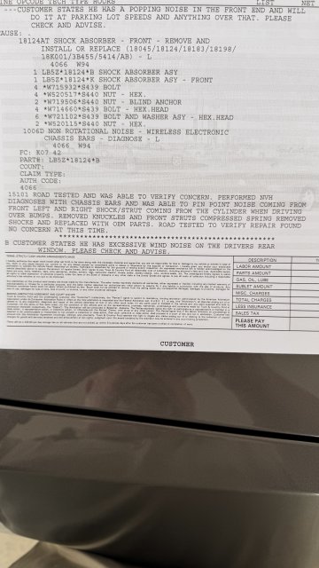

Rattle noise in front end?

It may not be the strut itself, but rather the strut top mount. Seems this is a common failure point on these Explorers. I think I had the same problem as you... it sounded like a dull knock when crawling at low speed in a parking lot, but no issues with ride quality. Fortunately for me, the dealer replaced front struts, mounts, and links on both sides under extended warranty at around 40k miles when I was having this issue.

Has anyone had a front strut make a clunking noise when the temperature gets in the 40’s?
23 Explorer ST
598
279
#29
I had that issue. Had struts replaced but the clunk was still there.
Dealership found the end links had slight play and replaced both sides. No more clunking.
Supreme Ruler
EMT
43
21
Washington State
#30
I had a mystery clunk from mine; it ended up being a loose front sway bar end link. The torque had to be to spec, not just two ugga dugga's.
226
104
Hull, GA, USA
#31
Mine ended up being the front sway bar bushing needed grease
2,067
1,442
#32
One of my front swaybar mounts ran dry and wore too big. A new set of bushings solved it. This was with a Steeda sway bar.
