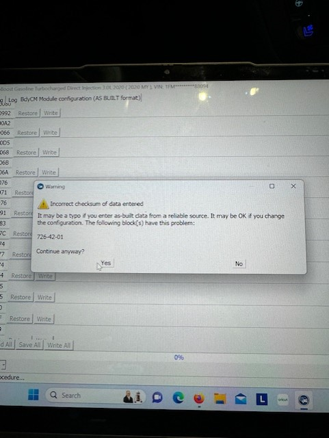

Question for the professionals. I was attempting to make this change and went to write the 404 change. A warning came up on FORScan about incorrect checksum of data entered. Should I just continue?
You ever get this figured out? I ran into the same error message. I just hit yes and didn’t have any issues, but doesn’t look like the changes worked.
