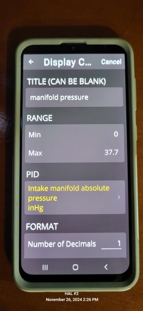

I'm still trying to figure out how to get these PID's to show up (trans temp, boost, IAT, etc). There is a bit of a learning curve.
powerboatr
718
474
O
Once you load the ford specific pids, vice sae pids..it takes a bit of drilling down
AiT and trans are easy to find
But the boost ...not so much
The pid does not say boost
Instead look for manifold pressure
It reads in inches of mercury and is absolute
So engine off...key on you will see current atmosphere pressure.
You have to build tye gauge to swing below zero and up to 20

Also AIT. Has more than one sensor
I also picked up cat Temps inlet as sort of an EGT reference.
