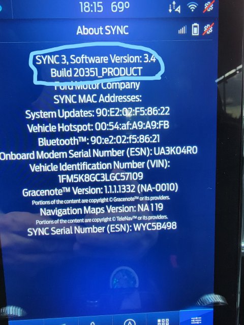

what version of sync do you have?
361
199
Ashburn, VA
It will be here (NOTE: this is an older version, 21194 is current build per Dale5403)... sync build.jpg
E
eagleGSU
Atlanta, GA, USA
It will be here (NOTE: this is an older version, 21194 is current build per Dale5403)... View attachment 8750
Oh I gotcha.
Mine says "Build 21020_PRODUCT"
so I have an outdated software? When was it last updated? It wasn't long ago when I updated, and it was in the ford shop just a couple weeks ago. I figured they'd check for updates as well.

Oh I gotcha.
21194 was released in late August.
