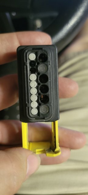

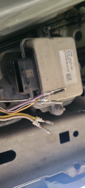

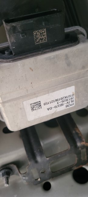

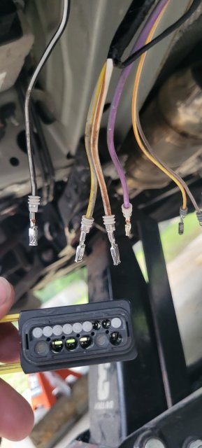

I drove over a tree branch and it pulled back the skid guard under the driver side. The six wires going into the clip connected to the (FPCM) Fuel Pump Control Module pulled out of the clip. The vehicle shut off immediately. I can literally put them back into the clip as there's no wire damage. But I cannot find a diagram anywhere online of what color wire goes where!!
The vehicle is a 2020 ford police interceptor utility. Should be the same as the 2020-up ford explorer. I hope at least. I'll attach pictures for reference. If anyone can please help me, it would be soooo greatly appreciated!!!

I checked the 2023 Explorer service manual (interceptor included), it showed a different 8 pin connector with 6 conductors. Your best bet may be to buy one from a local Automobile recycle center and cut the harness from the donor Explorer as far back as you can then splice it into your harness, I would not trust pins or the connector that had the conductors pulled out in that manner.

That's definitely a great idea! I wonder if any salvage yards in my area would have a police interceptor that new however. I could always take it to the dealership. Just sucks to spend that much on something that I could literally fix in a few minutes if I had the colors/positions diagram. Oddly enough, the metal clips on my wires still look perfect, along with the waterproof rings. I can click them back in no problem.
A friend of mine has a 2025 explorer, but from the sounds of it, the wires could be different. Maybe I'll take down her skid guard and just have a peek to see. Assuming it's even in the same location lol.

Well, I checked the 2025 explorer and it's a round plug that's nothing like mine. If anyone has any info, please feel free to help
