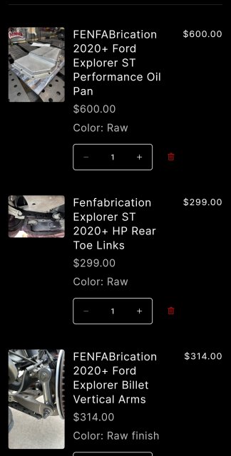

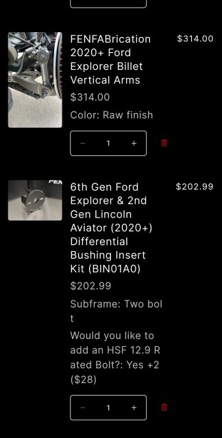

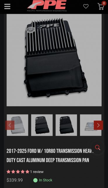

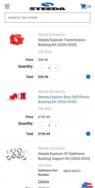

Please give me parts or disadvantages that I don't recommend
대한민국
2023 링컨 에비에이터
The reason for asking is that there are many disagreements
Please point out things you don't need

Trans Mount Insert: I haven't heard any reviews of the Steeda one, but Travis at HSF had good things to say about the Fenfab one (same idea, not sure on durometer differences)
Rear Pinion Diff Bushing: I'd skip these. There are some horror stories about these. The diff can have some movement in it; it isn't meant to be solid-mounted. You already have a 4-bolt so just skip this one.
Subframe Bushing Inserts: 100% YES. Should be the first mod every owner of these cars does. Major improvement in rear end control.
FF Oil Pan: Yes. The data demonstrates this is an improvement.
FF Toe Links: Yes. The factory ones are crap that can bend when you breathe on them. I noticed a nice improvement (I have Steeda ones)
FF Vertical Links: Yes. Solid improvement. Just grease the crap out of cup contact points.
JXB Diff Inserts + Bolts: 100% YES. Major improvement. Should be done at the same time as the subframe bushing inserts.
PPE Trans Pan: I like it for the ease of future fluid changes. Skip the deep version; doesn't help like an older transmission.

Oops yeah missed the pinion bushings. OP skip those, and also get the transmission mount insert from Fenfab. As far as deep oil pan, might as well get it, if you’re paying to get a new pan might as well get the bigger pan.

Agree on the bigger pan. If you are getting one anyhow then more fluid is always better imo.
1,688
1,139
Transmission Mount- Get the FenFab product. Support the small business.
Rear Diff. Pinion Bushings- Don't waste your money.
Sub-Frame Bushing Inserts- Definately worth the money!
FF Oil Pan- Good investment! See the thread here.
FF Toe & Vertical Links- Both are good upgrades as the OEM tend to bend.
JBX Bushing Insert- This, along with a differential brace, really helps. I think ID Speed makes the best one. ID Speed Diff Brace
PPE Trans Pan- Pricey but it makes changing the fluid a whole lot easier.
