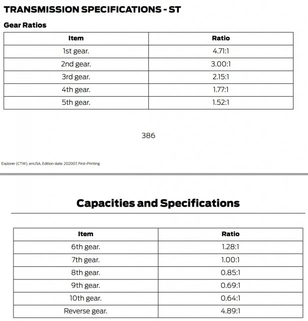

I did some digging on the transmission gearing and it's the same for all models. Here is the info I found: 2020 Explorer Tech Specs
The same file points to it being the exact same engine as well between the two physically.
What I find interesting is that the owners manual (I downloaded a copy) makes it seem like the ST is different, but it's not.
Edit: More info
I did find on CarAndDriver that the final gear ratio is different if they are correct
Final Drive Axle Ratio :)1) 3.58 - ST
Final Drive Axle Ratio :)1) 3.31 - Platinum
