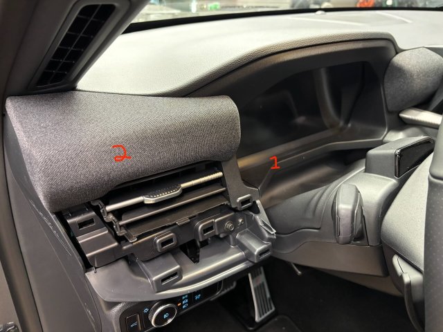

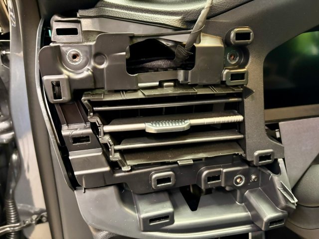

Hi guys - I've searched high and low and Grok confirmed it can't find a video or post anywhere showing the installation of the P3 gauge in a 2025 or 2026. I'm getting ready to install mine and don't want to just start prying on things without some knowledge. I've watched HSF's videos and while very helpful (not sure if Travis is on here but he's a hell of an asset for our community) it doesn't fully apply to a '25-'26.
Hoping someone here has installed a P3 on a '25 or '26 and can give me a couple pointers.
The first 2 trim pieces are easy. Based on the photo below, I'm guessing I next need to remove #1 which is easy enough (yes I have trim tools). But how does #2 come off? I'm expecting this is one of the B&O speakers and the last thing I want to do is break something. What other pieces do I need to remove?
Help me Obi-Wan Kenobi, you're my only hope.

You don't have to completely remove one, and two just pulls out. It's a speaker, and does have a wire w/ a clip, and it's all on there pretty tight, but nothing you're going to rip apart unless you have herculean strength.
5,773
6,982
1 is just barely snapped on. Pull it straight up.

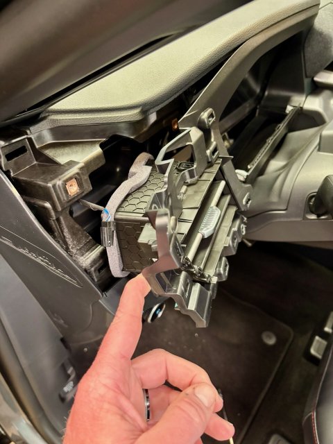

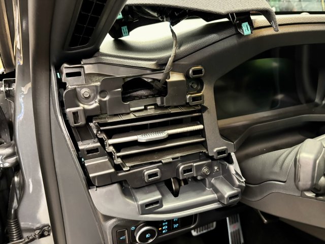

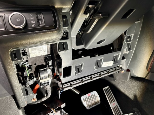

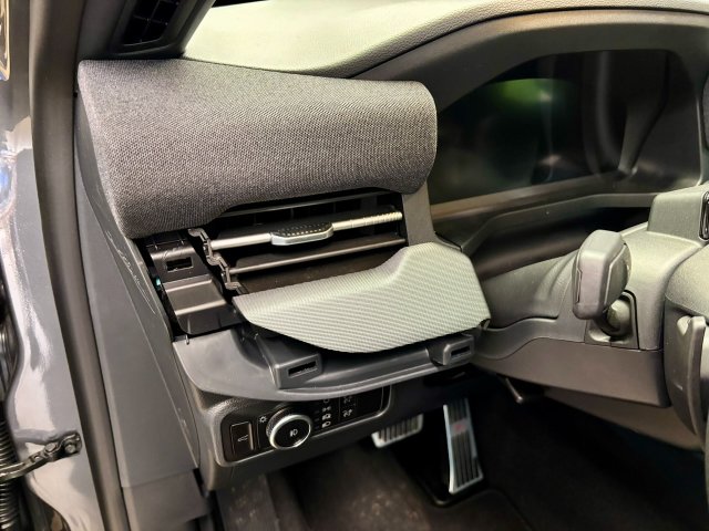

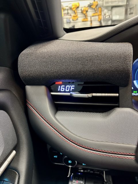

I said I'd come back with installation pics to help the next guy, so here they are. I will say I over thought this. The interior pieces all pop right off, I would suggest a trim tool for both the B&O speaker pod as well as the panel below the steering wheel, but for every thing else, just a gentle and steady pull will pop them off. The hardest part (for me) was fiddling with the vent reassembly, I could have used a third hand. I didn't read the P3 page close enough and didn't realize the gauge doesn't provide Oil Pressure, that's odd and one of the big ones I wanted, oh well.
