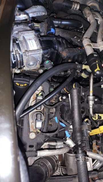

I just installed the Fenfab v2 intake and charge pipe with HKS BOV. My car threw a P04DB code on the 3rd drive cycle. I'm sure I installed the intake lines correctly, but what might cause this? 1000004646.jpg

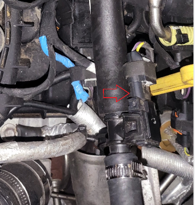

This connector appears to be unseated.

Great eye Wafer! Tracked let us know if that fixes it…

I just went out and re-inserted that connector and it appears to only go in that far before clicking on.

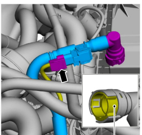

Was that sensor originally closer to the 90° fitting as in this picture?
Your code is a Crankcase Ventilation System Disconnected warning, I've read the sensor also has a hall effect pickup that detects when the Vent hose is moved.
Yeah it was definitely facing in that direction and is no longer. Maybe I need to trim my hose so that it can be repositioned that way as the hose is too long to allow it to go back to that direction?
Yes try to reposition it to face to same direction and at the approximate distance from the fitting, hopefully it will clear the trouble code.
