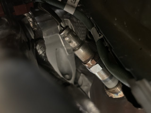

Just looked at a hsf video on youtube are the o2 spacer on the lower catalytic the same as the defoulers? image.jpg
269
147
Farmers Branch, TX
Just looked at a hsf video on youtube are the o2 spacer on the lower catalytic the same as the defoulers? View attachment 30010
Correct, that extension between the sensor and the threaded bung in the downpipe is the defouler. I'm 99% sure they're only needed for the post-cat O2 sensors.
