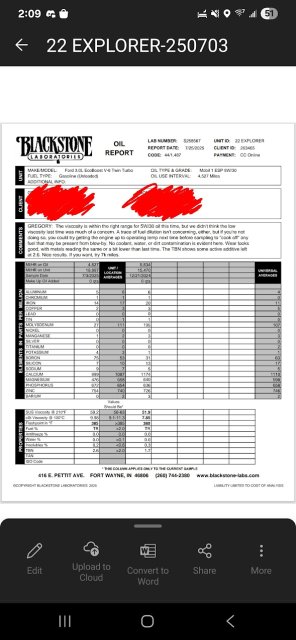

The sample @ 15k miles is Motorcraft 5w-30 full syn, the second sample @ 20k is Mobil 1 ESP 5w-30.
As you can see the Motorocraft broke down to a 20wt, the M1 ESP did not. Granted it did have 1k less miles on it.
