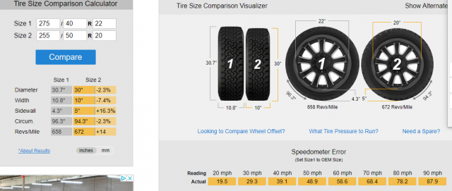

Looks like I found a good deal on a set of 255/50r20's that came off an explorer. 2.3% smaller radius/circumference. 1685040541904.png
