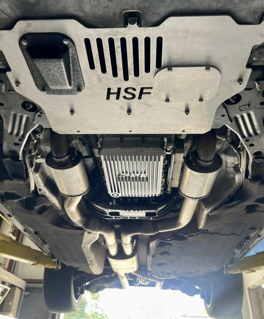

Rest of the setup is lethal midpipes and the Borla Atak rear. Has anyone installed additional resonators or mufflers to tone it down any?
If so, recommendations and possibly pics of locations?

att.akD8LHTM6g-mHND1VhNMDCkcgE8LYwfNZAQUqDNyazc.jpeg You can add a pair of Vibrant Ultra Quiet resonators to the downpipes, you’ll just have to shorten them a bit. You may also want to switch to the Borla S or better yet the Thermal R&D 2.5” system to tone it down even more.
