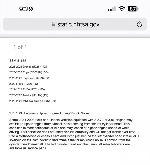

Ford called.. just as I suspected. “Normal noise” and claiming it’s TSB SSM51665 with no drivability issues or repair required. Annoying.

I would take it to another dealer for a second opinion or have the shop foreman look at it. There is a tsb for phasers in these eco boost engines
