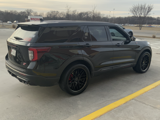

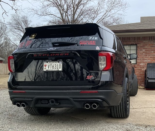

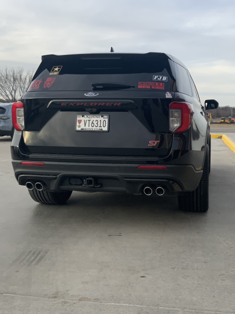

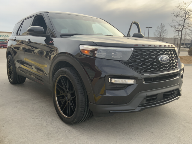

Blaque Diamond BD-27 Wheels 22 x 10.5 5x114 +33 offset .
CONTINENTAL SPORT CONTACT 5P 325 /35 R22 tires.
I ended up using 5mm hub centric wheel spacers I bought , the tires were a little too close for my comfort zone to the front struts with just the +33 offset the wheels had .
So if I’m doing this right I’ve ended up with a +28 offset .
Rear tires have no issues with clearance but I still used the same 5mm spacers to square it up .
Tires and wheels have a slight poke out from the stock fender flares , maybe about 1/2 inch or so .
I plan on getting a wide body fender flare kit soon though. I’ll post better pics later when I get it cleaned up
Tires are 2” wider than the stock ST 21” wheels with 275 44 21 rubber .
