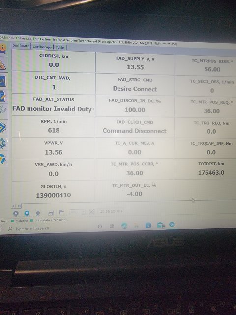

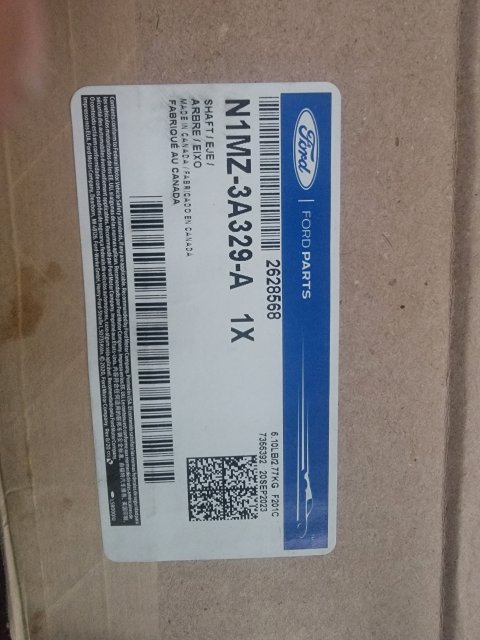

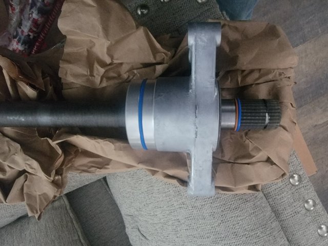

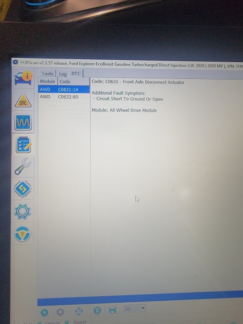

Wondering if anyone has information on this new intermediate shaft/ actuator assembly.
I am having the C0631:14 and C0632:85 show up on forscan. With a ton of errors on the dash.
I found a TSB that listed a bunch of parts for this. I found the oil dripping out of the intermediate shaft area also while i was troubleshooting.
My parts came in but my intermediate shaft is definitely different. And it doesnt look correct. Is there a part number for the intermediate shaft with the housing for the actuator that will actually connect to my new axle?

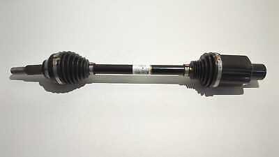

that IS the correct part. It is no longer an actuator--just an "intermediate shaft" that is connected always. This is the latest version--the previous replacement for the FADA kind of looked like the FADA but with the connector port taped over. Note that with this newest version, the old left axle will not work. You need to get the new axle listed in the TSB. Definitely let us know how the install went. You have to lower the front subframe. You will also need FDRS to install the latest AWD firmware and choose the option "no connector" for the intermediate shaft question.

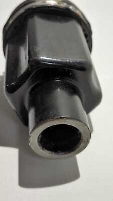

New axle:
Note the inboard side is now female which would mate with the intermediate shaft you have pictued.

Thanks you for the info. I am waiting on my mongoose cable and a day to do this. I also just noticed that they sent me a rev E axle not the F. That must be why i am confused. Since they both have splined shafts. The new F rev must be the new design to fit with this intermediate shaft.
Looks like i am returning axle and ordering the correct one.

that IS the correct part. It is no longer an actuator--just an "intermediate shaft" that is connected always. This is the latest version--the previous replacement for the FADA replacement kind of looked like the FADA but with the connector port taped over. Note that with this newest version, the old left axle will not work. You need to get the new axle listed in the TSB. Definitely let us know how the install went. You have to lower the front subframe. You will also need FDRS to install the latest AWD firmware and choose the option "no connector" for the intermediate shaft question.
New axle:
View attachment 21368 View attachment 21369
That makes way more sense. I was like how the hell do i get these to connect.

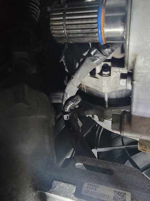

I used a block of wood on top of the jack. Slid that underneath the bellhousing. Wasnt perfect but it worked. I could only pump the jack like a mm at a time. Took some time. The book says to remove the entire block and put it aside. I could not figure out to get that block out of there. I had the trans line block removed and the bolts that hold the downpipes to the black bracket just past the bellhousing removed also.

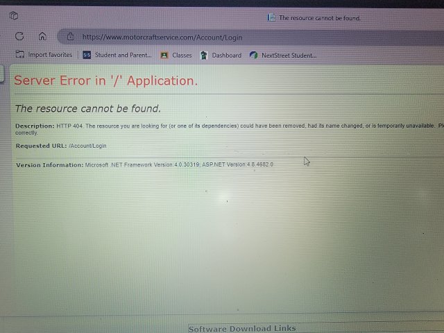

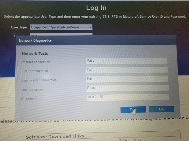

Alright guys this drama never ends here. Bought a 2 day license and i cannot get FDRS to login. Attached a pic of the issue. Are these servers down?
1,493
733
I'm sure you are googling possible problems. There should be no issues like that so I think something is going on that is not on your end. Just be aware that if you can't get it to work, call support when you do and they can credit you another 2 days for the license.

Thanks. I can get it to show passed for all. If i click on dealer it takes me to the motorcraft login. If i select independ/non dealer it goes nowhere and comes back with no connection. I am logged into motorcraftservices site. From there i can login to the other site where i purchased my 2 day license.
If i pick ETIS it fails and then my network icon goes from green to red.
As for the diagnoex website i do not have a login there and it shows no such email when i do a forgot password.
No clue.
259
80
Desert South West
No clue.
I had the same problem a few months ago, have you tried a different web browser and or computer?
