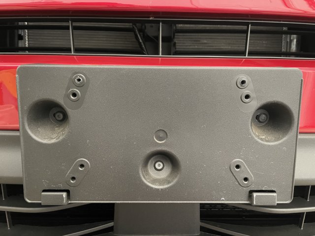

So, just got my BumperPlugs today…took off the front plate and WTF. There are 3 holes? And they arent screws. How do you remove these? And what did you use to plug the whole in the unpainted part? Or did you leave it?
Not very happy with 3 holes…I hate front plates with a passion.

Plastic rivets. Just drill them out.

and any autoparts store will have black textured plastic push rivets that fit in that hole.

Thanks! Not sure I’m going to be thrilled with having that plastic rivet filling the 3rd hole. Oh well. I’ll see what I can do.

Not really a "Rivet" they are a push pin or "Christmas Tree" like what the Bumper plugs are. I scuffed mine with 600 grit sandpaper and sprayed it with matte black to match the trim better.

Those look good! I need to get rid of my front plate bracket as well. Terrible that they put these on this way!
