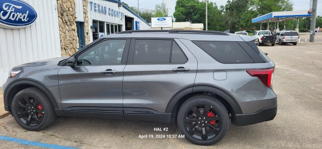

I picked up this gem today, it was built mar 2023 and has been sitting on the dealer lot since mid april or so 23
drive home a few thoughts
is there a FORSCAN change to get a boost gauge, or a real tach vice a line up the side of the speedo
and is there a forscan spreadsheet like we have for f150 and super duty trucks
test drive was hmmmm OMG this puppy shiits and gets even in ECO mode
