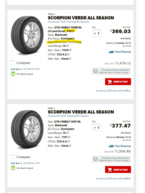

The OE's apparently do not have this "Noise Reduction Technology" Unless, for some reason it does not specify on the product description.

There's usually a mfg code as part of the name/nomenclature, for example, LR is molded into Land Rover OEM tires:

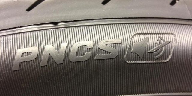

Pretty sure they should be labelled "PNCS" on the tire. I thought only a few Platinums got this tire but looks like not. 63980_pncs-system-redukcji-halasu-pirelli-nowosc_1.jpg

Mine have this PNCS label on them as well. The OE tires do not mention this within the product description but if you zoom in on the tires themselves, it has this labeled.
