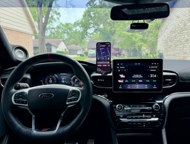

Finally had time to get this thing installed. Everything is doing what it should and I’m headed over to see Travis at Houston Speed freaks now for the foreskin changes since my license expired. I’m almost done with the trim piece to cap the bottom but I just haven’t had time to work on it.
5,136
6,160
Thread Starter #12
Forscan mods complete. All is well…everything including massaging seat functions are operational on the screen. It does appear that the ambient lighting color list is wrong…I never change it anyway so not something I’m worried about. IMG_6192.jpeg

Finished up the bottom cap today. I took the other housing I had and cut it into 3 pieces, CA glued them together then hit them with some epoxy to make it solid then a little body filler to shape followed by adhesion promoter, primer and paint. Honestly I didn’t even try to make the filler perfect…nobody is ever going to actually see the bottom. I just wanted it smooth for when I’m reaching into the tray under there.
I may at some point play with my own mount to move the screen closer to the dash. It looks fine as is but I think it would look better about an inch closer. That’s a project for another day though.
