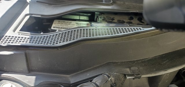

The battery is located at (left side under the hood). behind the battery is the air circulation vent and I've noticed when the car is off it AUTOMATICALLY opens up. I have a 2022 st and right now I'm dealing with a mouse problem. It has direct access to the cabin filter from under the hood. He is able to get thru a large gap along the fender. He has already chewed up two of my cabin filters luckily he didnt get all the way through (cought it on time) the rodent is literraly nesting next to the battery. I'm trying to see if there is some sort of override to keep that vent closed when the car is off or ima have to resort to chicken wire I need some help trying to mitigate this issue

I attached the pictures of what I'm talking about and the way it's getting in I even included the chew marks :D

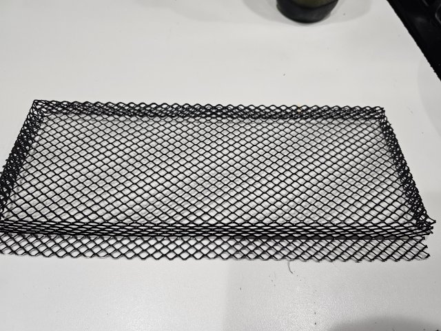

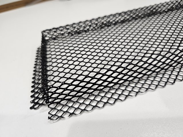

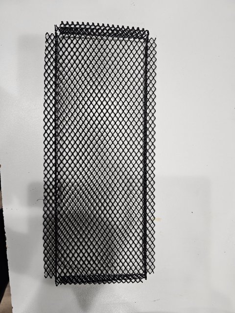

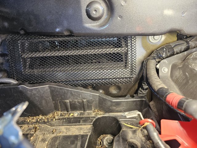

I found gutter gaurd at ace hardware cut it up and bent it into shape then used hot glue to attach without drilling

Would you please provide some dimensions for the screen or the location to gather those dimensions along with a photo of the completed mouse screen? THANK YOU!!!!

WELL, DUH ON ME!! THERE IT IS!! Thank you!!!!
