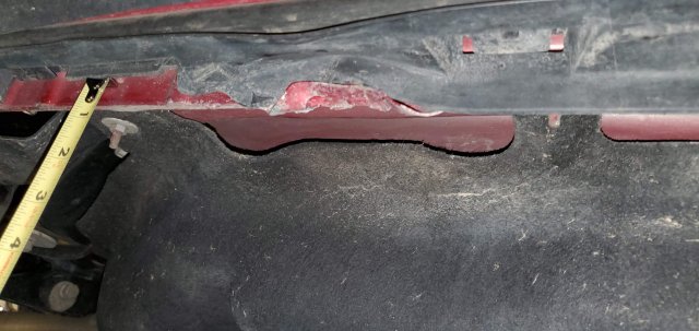

Brought it in for oil change, the hacks used a frame lift and did not properly place the pads on the lift points...which are clearly indicated by ford under there.
Result was 2 folded over body tabs and with lots of paint cracked off.
Had I not brought it in for oil undercoating somewhere else I would not of known.....and the rust would begin.
I use 2 dealers, and each have done an oil change so I'm not sure which hack caused the damage. But I am sure they are both capable.
I spent an hour straightening, sanding, and repainting the two areas. These are the rear areas where a momo, without looking, would swing a lift pad under.
The tabs in question hang down and are susceptible to getting crushed causing paint flake, then rust.

Got under mine to check the (VERY Obvious marked lift points) and found the same tabs damaged on both sides. Thanks for the heads up, and I'll be cleaning up their work and priming at least before MN Winter hits....The lift points even have two molded arrows pointing at each other and there's a molded knock out inboard where the factory jack would need clearance. Damaged Body tab from Improper lifting of Explorer.jpg
