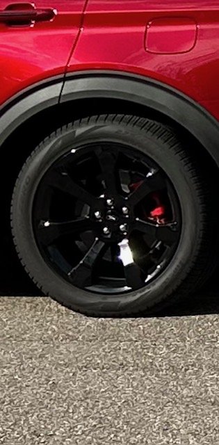

does the car 'squat' in the rear ? or the springs are stiff enough?

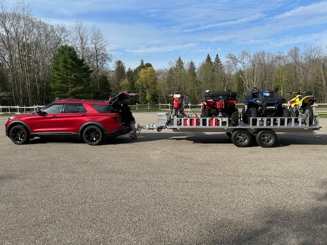

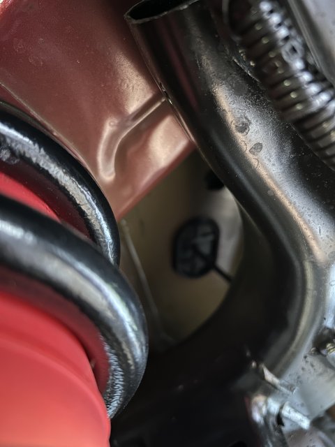

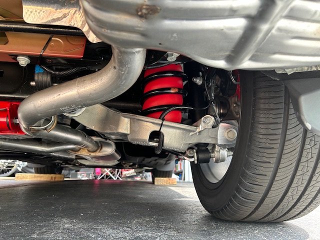

Just an FYI and I thought this may be helpful - I pull roughly 4,500 lbs when my trailer is fully loaded and with a tongue weight of around 365 pounds. The pic's below are not with my trailer fully loaded but the tongue weight is still at approximately 365 pounds because of everything in the cargo box at the front of the trailer.

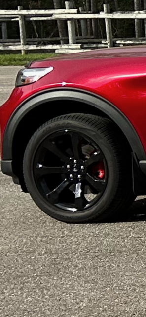

I never liked the squat it had with the trailer. It exacerbates the look because any squat in the rear also forces the front upward a little. This was with my 22' ST. I have close up pics of the front vs. the rear below.

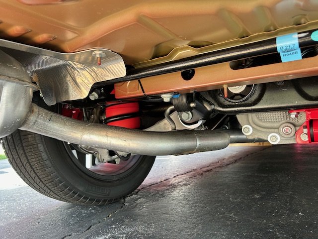

I bought a new 25" ST and added AirLift helper spring air bags to the rear springs. You can add or remove air to get the vehicle to remain level with whatever tongue weight you have. They are highly reliable, have a lifetime warranty, and only cost about $150. Pics of the airbags on the new 25' are below. **I didn't have to but for added convenience I also ran the air lines to the inside of the vehicle and added a pressure gauge.

thanks. I use them too. what size u got? also i saw you use camco ez lift 1000 pound hitch ,with 2 husky sway control bars
do you happen to have the product# please?

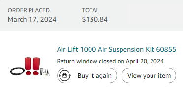

I ordered the
I ordered them through Amazon, kit #60855

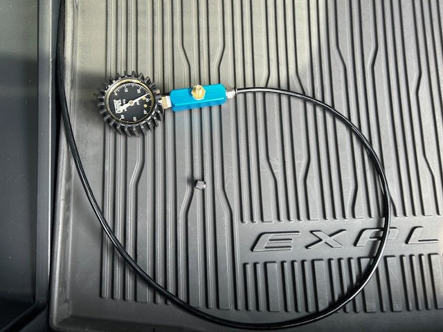

I like the pressure gauge setup. Where did you run the lines thru to the cargo area?
486
472
#31
I went through the floor plug located on the drivers side, just before the spare tire. I can't remember if there was enough room on the other side of the plug, inside of the vehicle, to allow for the line to not get kinked, or, if I added a 90 degree quick disconnect hose fitting just on the other side of the plug.
From there I routed the line into the hidden compartment area. I made sure to leave more than enough line than I will ever need.
