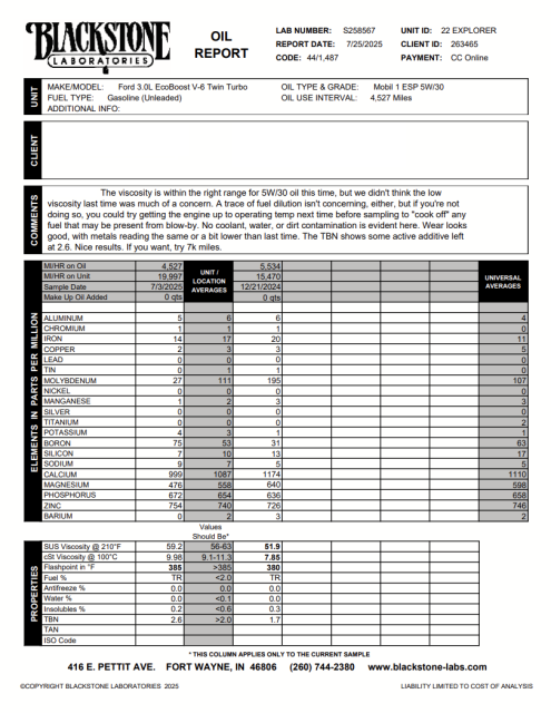

Got my 2nd oil report done. Swapped to M1 ESP after the last report showed a huge drop in viscosity with the Motorcraft Syn.
20k miles on engine, 4.5k on oil.
Good info that backs up my decision to use Mobil 1. Using a synthetic blend from the advance auto “house” brand oil in a twin turbo truck is some cheap shit lol
No kidding, the Motorcraft is made by Phillips66. The full syn is just re-branded P66 Shield Valor/Kendall GT-1 and the Semi is regular Shield. Not a bad oil but for the price of Motorcraft you can do so much better.
