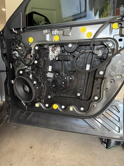

I recently swapped the stock front/rear speakers for the PowerBass 6x9" and 6.5" components, and I already have a JBL BassHub sitting inside the spare tire. For a budget system, it's actually quite impressive. Of course, I've deadened the doors and trunk with Killmat so I'm squeezing what I can out of the OE without going nuts. My question is about what others have been using for a decent budget midrange. The stock mids are a weak point, and now that I've already swapped the midbass and tweets, I just want to round it out and call it a day.
What I've tried so far are the PowerBass 2.75" to see if they'd fit, but of course they were a bit small for the space...only $25 so no big deal to test. I then ordered their 3.5" coax even though they're not really going to run full range, but they're a bit too deep, and I don't want to mod the grill...Again, only about $25.
I know @UNBROKEN used Focal 3.5", but in my setup that would be excessive compared to the PowerBass drivers and just cause me to go down a entirely new rabbit hole. Maybe I already know the answer and I just don't want to admit that what I'm looking for doesn't exist, or maybe I'm manifesting in hopes someone turns up a cheap alternative that will pair with the modest upgrade I've started. Thoughts?

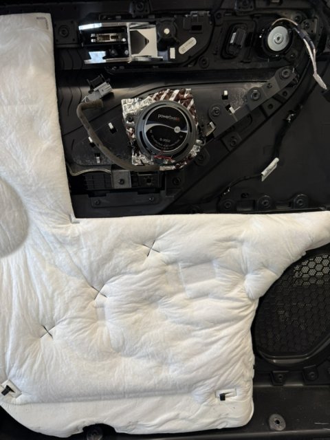

Welp, no patience here...I went ahead and just installed the 3.5" PowerBass speakers. Had to cut away some of the door panel to get them to seat. Used Killmat around the surround behind the grill, and covering the hole in the door panel. Is it an upgrade, yes. A bit less lively than the stock paper cones but definitely less harsh, and there's a more filled out soundstage. They're only 85db sensitivity so softer than their components, so I actually had to turn the midrange up. All considered, for less than $500, replacing all speakers and adding the powered sub did wonders. It ain't winning any competitions, but it's far better than the stock setup. I'm pleased. 3C56DCFD-2F28-4D79-8DF4-B7A4C60F7252_1_105_c.jpeg
