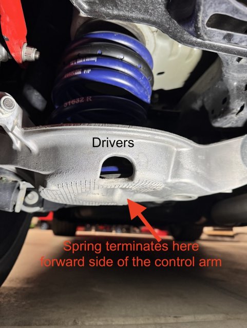

I have a theory why only the passenger's side rattles.
The factory coils are linear and identical side to side. Because they are linear they have evenly spaced coils that do not contact one another, allowing for variation in spring behavior when installed on both sides. No interference, no noise.
The H&R coils share the same features as they are the same part side to side and terminate the coils at the same place, matching the shaved lower and unshaven upper ends. This normally would not be a consideration for discussion but H&R uses a progressive coil which has at least three coils in contact once the weight of the vehicle is loaded.
This difference may have an influence on the spring behavior because of the fore and aft movement on the lower control arm and the clocking of the spring from one side to the other, especially with the top coil sitting on a flush surface. You can see that the spring does not clock the same way on each side of the vehicle. This would partially validate why the sound would be more prevalent with a load on the vehicle (accelerating) as the control arm bushings flex changing position of the lower control arm influencing the spring. It's possible the driver's spring makes no noise because the clock is in favor under load.
Kicking around ideas.

Good theory, pics are great support (no pun intended) to the text.
You may want to share your idea with H&R because they may not know that the spring stops on the ST lower arms are not in the same spot. Not sure how prevalent asymmetrical perches are but i was surprised (from a Mustang perspective) to see it.
Your documentation will be a big help to others trying to find a mystery metallic squeak.

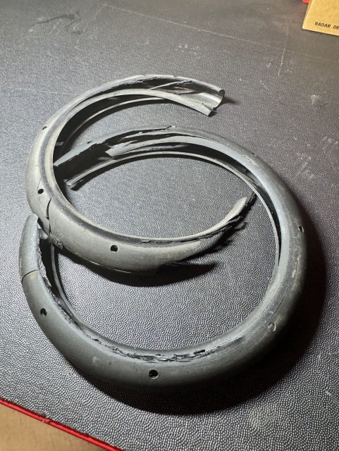

I did speak to Eibach and they said they add isolators to their springs because in testing, although rare, they would get a rattle from the coils which make contact. This is omitted from H&R springs.

H&R sent me a set of isolators and called it a day.

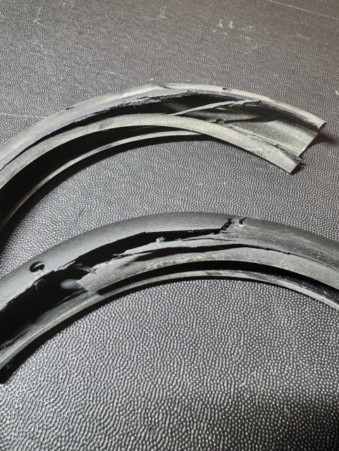

Swapped isolators. The H&Rs are thinner which is good because the others raised the rear 1/4 inch and they are larger in diameter fitting the spring better. The H&R isolators also have an adhesive.
That all sounds great! The adhesive is a big plus and the thinner material keeps the ST away from a monster truck stance (just a slight exaggeration). And kudos to you for going through rear spring install AGAIN to apply the H&R solution.

Update: Springs still make noise but is more of a clunk now with the isolators. I am thinking of getting either an Eibach for the rear or a linear spring to avoid the issue entirely. The H&Rs just make too much noise on their dead coils.
