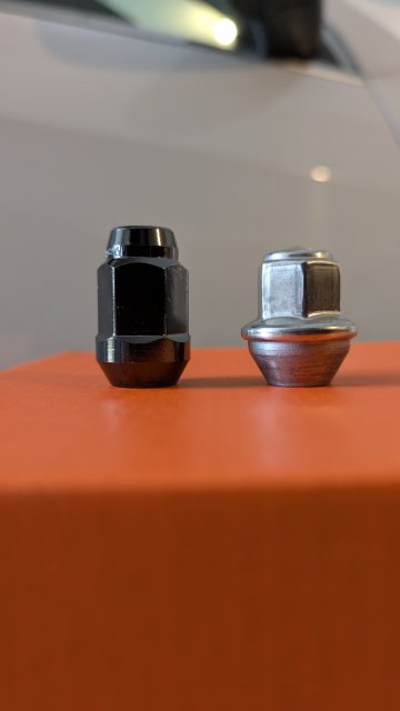

UPDATE, Amazon actually came through and delivered all 5 sets within 2 days. For reference, I took a couple pics of the stock nuts vs the McGard's in case someone else had questions. I think they look really good.
McGard 64074 Cone Seat Bulge Style Lug Nut
https://www.amazon.com/dp/B00G93FW46?ref=ppx_yo2ov_dt_b_fed_asin_title
View attachment 29510 View attachment 29511
Following up on this ...
I got the McGard 64074 and I found out that, there's about 2mm difference in the seat diameter between the OEM's (~27.40 mm) vs ~25.25mm for the McGard.
Is this safe at all?
Only concerned about safety not the looks, but I do think they look OK though.
5,603
6,786
That’s fine
