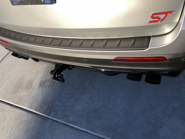

I couldn’t bear the thought of shelling out $1200 for shiny pipe, so I had a local shop help me out. They swapped the stock resonator for a comparably sized dual-in/dual-out MagnaFlow muffler. Then they ripped out the stock mufflers and added some pipe to fill in the gaps, and finished with some matte-black Y-tips. It has a deeper tone at idle and really opens up under acceleration! It has a small drone at random speeds in sport mode, when other modes would have swapped gears at speed/rpm (like 45-50ish in 6th). Above 85 the drone kicks in again, even in 10th...

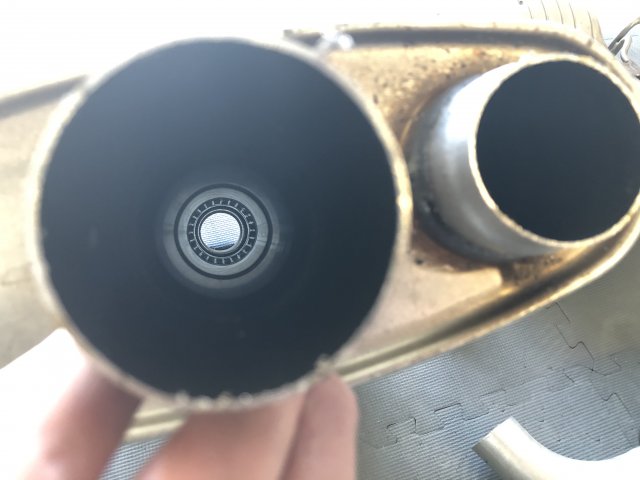

The OEM resonator is a straight through design, but it looks to have a weird bit of baffling and ridges for air to get caught up and bounced around. They are also slightly different from side to side, and I’m not sure which way it was mounted in the vehicle. Also, taking a picture through a dark tube during the day probably didn’t help...

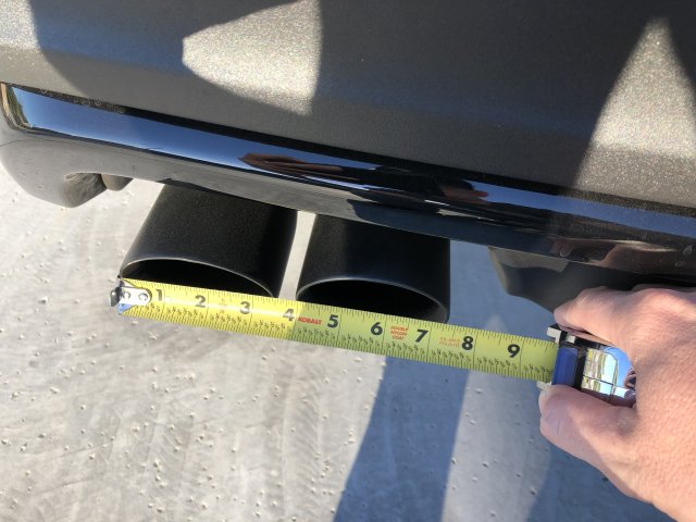

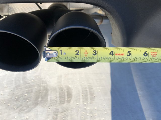

I think the dual-wall tips are 3”, but I can measure tomorrow morning. I dint want to wake anyone up by turning on and off the alarm at 1am. (Edit = They are 3.5”)

3.5”
Forgot to mention that the tips are equal length, and I had the inboard tip even vertically with the bumper. Because of the curve of the bumper, it makes the outboard tip stick out just enough...

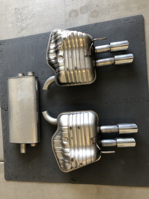

You're getting terminology all mixed around here: the forward "muffler" is the resonator, the other two at the tail pipes are the mufflers. The resonator itself is there to change the sound in whatever way the engineers tune it. Even being "straight through", all the perforations in the tubing will deflect the exhaust waves through the inside of the casing before it flows out to the mufflers. I'm sure that removing it and replacing with an actual 'X' or the DynoMax version (if one fits) will definitely make a difference. Whether or not I want to be the one that experiments with it is a different story since I'm hoping Magnaflow will come out with a system that sounds better than Borla.
